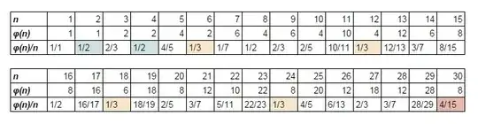

Firstly: the function $\phi(n)$ does not have the lower limit in the form of a straight line with a positive slope.
This follows from the formula $$\dfrac{\phi(n)}n = \prod\limits_{p\,|\, n}\dfrac{p-1}p,$$ formula, which illustrates non-increasing of $\dfrac{\phi(n)}n$.
Analysis of the formula leads to the following conclusions for : $$\dfrac{\phi(np^k)}{np^k} = \begin{cases}\dfrac{\phi(n)}{n},\text{ if }p\,|\,n\\\dfrac{\phi(n)}{n}\dfrac{p-1}p,\text{ if }p\!\not|\:n\end{cases}$$ These findings can be illustrated by a simple table: Euler phi
So, not difficult to prove that $$\dfrac{\phi(n)}n \geq H(n),$$ where $H(n)$ is a step function $$H(n) = \begin{cases} \dfrac12,\text{ if } n \in [2,6)\\ \dfrac13,\text{ if } n \in [6,30)\\ \dots\\ r_k,\text{ if } n \in [p_k\#, p_{k+1}\#)\\ \dots, \end{cases}$$
$\qquad p_k\# = \prod\limits_{i=1}^{k}p_i$ is primorial, $$\left\{p_k\#\right\}=\{2,6,30,210,2310,30030,510510,96996900,223092870,6469693230,\dots\}$$ $$r_k = \dfrac1{p_k\#}\prod\limits_{i=1}^{k}(p_i-1),\dots, \quad \{r_k\}=\left\{\dfrac12,\dfrac13,\dfrac4{15},\dfrac8{35},\dfrac{16}{77},\dfrac{192}{1001},\dfrac{3072}{17017},\dfrac{55396}{323323},\dfrac{110592}{676039},\dfrac{442368}{2800733},\dots\right\}$$ $$\{p_i\}=\{2,3,5,\dots\}.$$ This function is susceptible to various approximations.
