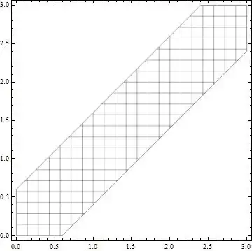

Needless to say, the above algebra for the CDF is not as simple as drawing a picture of the region $\{(x,y)\in[0,a]^2:|x-y|\le z\}$ and finding its area.
Here is a picture for $z=0.6$ and $a=3$: (Also see the case $a=1$ discussed in this post)
