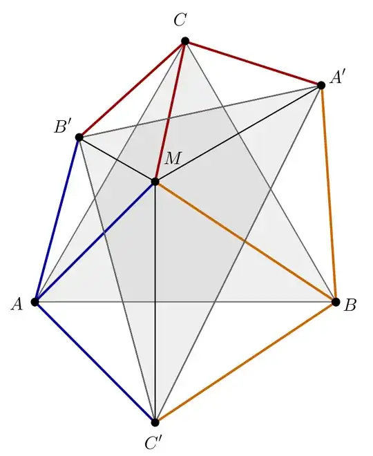

Reflect $M$ with respect to the sides of $ABC$. You get an hexagon whose area is $2S$: enter image description here The hexagon can be decomposed as the union between $A'B'C'$ (whose side lengths are $\sqrt{3}MA,\sqrt{3}MB,\sqrt{3}MC$) and the isosceles triangles $CA'B',BC'A',AB'C'$. It follows that $$ 2S = \frac{\sqrt{3}}{4}(AM^2+BM^2+CM^2)+ 3 S'$$ where $S'$ is the area of a triangle with side lengths $MA,MB,MC$. By Weitzenbock's inequality $AM^2+BM^2+CM^2 \geq 4\sqrt{3}S'$, hence $S'\leq \frac{S}{3}$ as wanted.
