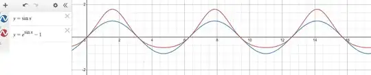

$e^{\sin(x)}-1$ has the same roots as $\sin(x)$. What is the difference between infinite product series expansions of $\sin(x)$ and $e^{\sin(x)}-1$ if they both have same infinite roots ?

    They may have the same roots, but effectively, sin(x) differs everywhere else in many ways from your function. Simple derivative analysis can show you that fact. They have different critical points, points of inflection, etc.. So, the series will be much different – KKZiomek Nov 17 '18 at 15:48

    If you mean the real variable $x$ then they differ by a function without zeros $\frac{e^{\sin x}-1}{\sin x}$ (compare with $p_1(x)=x-1$ and $p_2(x)=2x-2$). For complex $x$ the first function has more zeros, e.g. a solution to $\sin x=2\pi i$ is a zero of the first function that is not zero of the second one. – A.Γ. Nov 17 '18 at 15:54

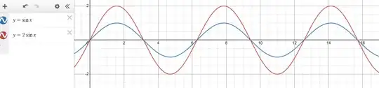

It is possible to consider an example of a non-zero multiple of a function. while they are not equal, they have the same zeros. enter image description here Similarly, the following functions even though have identical infinite roots but aren't the same. Therefore, we don't expect same power series expansion for such two functions. enter image description here
