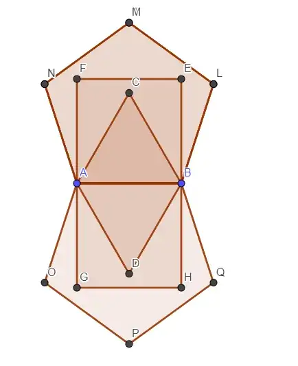

Given a segment $AB$ in the plane, draw all possible regular polygons having $AB$ as a side.
Is it true that if a line contains infinitely many vertices of those polygons, then that line contains either $A$, or $B$, or the midpoint of $AB$?

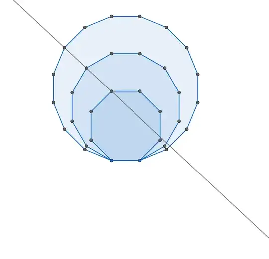

If we look at the polygons with $4n$ sides ($n\ge 2$)
We come close to finding a line where all polygons have a vertex on that line, and the line goes through neither A, B nor the midpoint of AB. It's not exact, but in mathematics appearances can be deceiving.

This is really just an attempt to establish what we're trying to solve in terms of complex numbers, where colinearity may be easier to describe, etc. $ \newcommand{\i}{\mathbf{i}}$ If we rotate 90 degrees, and work in the complex plane, placing $A$ at $+\i$ and $B$ at $-\i$, and only look in the right half-plane (because...symmetry!), then the polygon centers are all on the real line. The center of polygon $n$ is at $$ c_n = \sec \frac{\pi}{n} + 0 \i $$ and the $k$th point of that polygon is at $$ u_{n,k} = c_n + (\sec \frac{k\pi}{n} + \i \csc \frac{k\pi}{n}). $$
