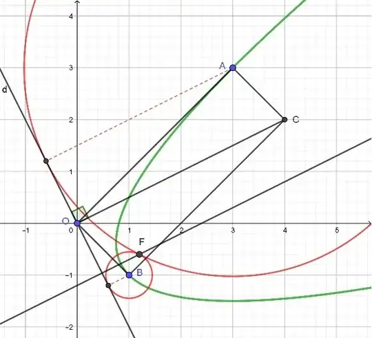

Let’s continue with the geometric construction that you started.
Construct the parallelogram $AOBC$. The diagonal $OC$ is parallel to the parabola’s axis. We know that perpendicular tangents meet on the directrix, which is perpendicular to the parabola’s axis, so we now know its directrix $d$. Construct circles centered on $A$ and $B$ and tangent to $d$. Their intersection is the parabola’s focus. You can simply divide $\overline{AB}$ proportionally to find this point: $F = {r_BA+r_AB\over r_B+r_A}$. You can then use the point-point and point-line distance formulas to obtain a Cartesian equation for the parabola.
The construction in the preceding paragraph took advantage of the perpendicularity of the two tangents, but it’s quite easy to obtain a Cartesian equation of a parabola from any pair of points $P_0$ and $P_2$ on it and the tangents at those points: Let $P_1$ be the intersection of the tangents. A Bézier parameterization of the parabola is then $(1-t)^2P_0+2t(1-t)P_1+t^2P_2$. Eliminating $t$ gets you a Cartesian equation for it. In this case, the tangents intersect at the origin, so we have the parameterization $$x = 3(1-t)^2+t^2 = 4t^2-6t+3 \\ y=3(1-t)^2-t^2 = 2t^2-6t+3.$$ Eliminating $t$ produces the equation $$x^2-4xy+4y^2-12x+6y+9=0.$$
