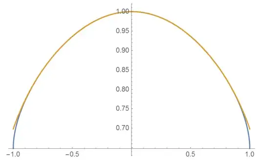

Here's an illustration showing how close the above series (orange) describe the function (blue):
