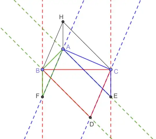

The answer of Moti is perfect. Note, though, that this also means that this property holds only if the orthocenter is inside the triangle, otherwise the external triangles overlap and the required property does not hold any more.
Internal orthocenter.
External orthocenter.

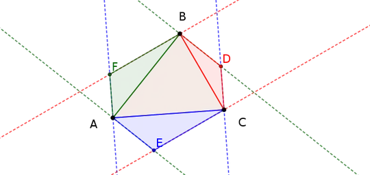

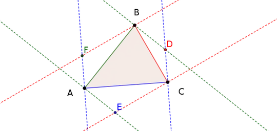

Here is a diagram with brief explanation (using signed areas and color code) to show that the result holds true for obtuse triangles also, that is the case when the orthocenter $H$ lies outside $\triangle ABC$.
$$[ABC] = \color{red}{[HBC]} - \color{green}{[HBA]} - \color{blue}{[HAC]}$$ $$[ABC] = \color{red}{[BDC]} - \color{green}{[ABF]} - \color{blue}{[CAE]}$$ $$[ABC] = \color{red}{[BDC]} + \color{green}{[AFB]} + \color{blue}{[CEA]}$$
