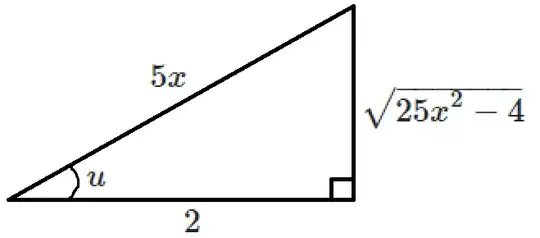

In more detail, note that $$ x = \frac 25 \sec(u) \implies \frac{5x}{2} = \sec(u) = \frac{\text{"hypotenuse"}}{\text{"adjacent"}} $$ so, filling out a triangle with acute angle $u$, hypotenuse $5x$, and adjacent side $2$, the remaining side by the Pythagorean theorem is found to be $\sqrt{25x^2 - 4}$:
From here, we easily see that $$ \tan(u) = \tan \left( \arcsec \left( \frac 5 2 x \right) \right) = \frac{\sqrt{25x^2 - 4}}{2} $$
Thus, $$ \mathcal{I} = \sqrt{25x^2 - 4} - 2 \arcsec \left( \frac 5 2 x \right) + C $$
