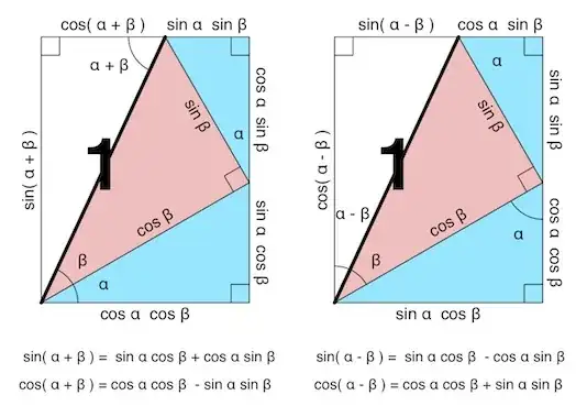

Well, you'd first have to know the following identity.
$$\cos(a\pm b) = \cos a\cos b\mp \sin a\sin b$$
The diagram below demonstrates it perfectly.

Edit: I am now aware that the diagram above is by Blue. You may want to check this link as well:
How can I understand and prove the "sum and difference formulas" in trigonometry?
KM101
  • 7,194
    I'm flattered that you believe the diagram "demonstrates [the angle-sum relation] perfectly". In the future, I hope you'll be a bit more conscientious about citing the source and/or the creator (in this case, me) of any content you "quote". (Far too many web communities circulate far too much uncredited content. Math.SE can do better.) Thanks! – Blue Nov 07 '18 at 13:50
    I saw your “Trigonography” site and it had great stuff, but I wasn’t aware that this particular diagram was yours. :-) Sorry about that, I’ll definitely pay more attention from now onwards. – KM101 Nov 07 '18 at 13:57
  • I appreciate it. :) BTW: If you didn't get the diagram from the answer I linked above, then where did you find it? – Blue Nov 07 '18 at 14:05
  • As a matter of fact, I was searching for diagrams for $\sin(a\pm b)$ and $\cos(a\pm b)$ while I was self-studying trig identities. But I didn’t really pay attention to the link. :-) It was one of the image results. (It certainly wasn’t MSE.) – KM101 Nov 07 '18 at 14:12
  • Fair enough ... I should've started watermarking my images sooner. ;) – Blue Nov 07 '18 at 14:15
