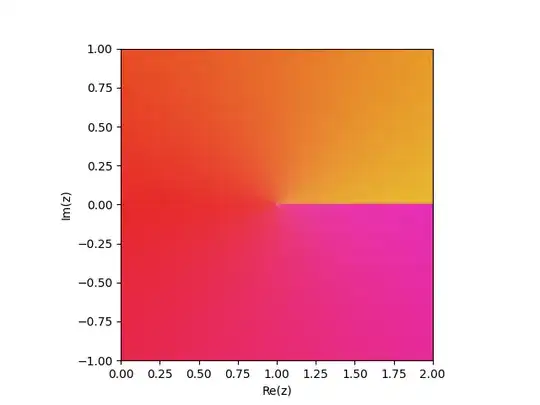

$K$ has a branch cut on $[1,\infty)$:
(The above plot is actually that of $K(m)$, with the parameter, but $k>1\implies m>1$.)
So either sign of the imaginary part is equally valid. Most implementations of $K$, however, take the principal branch of the square root in the defining integral. This leads to the reciprocal of the principal square root of a negative number, a number of the form $\frac1{ix}=-i\cdot\frac1x$ where $x>0$. Therefore $K$ has negative imaginary part if $k>1$.
