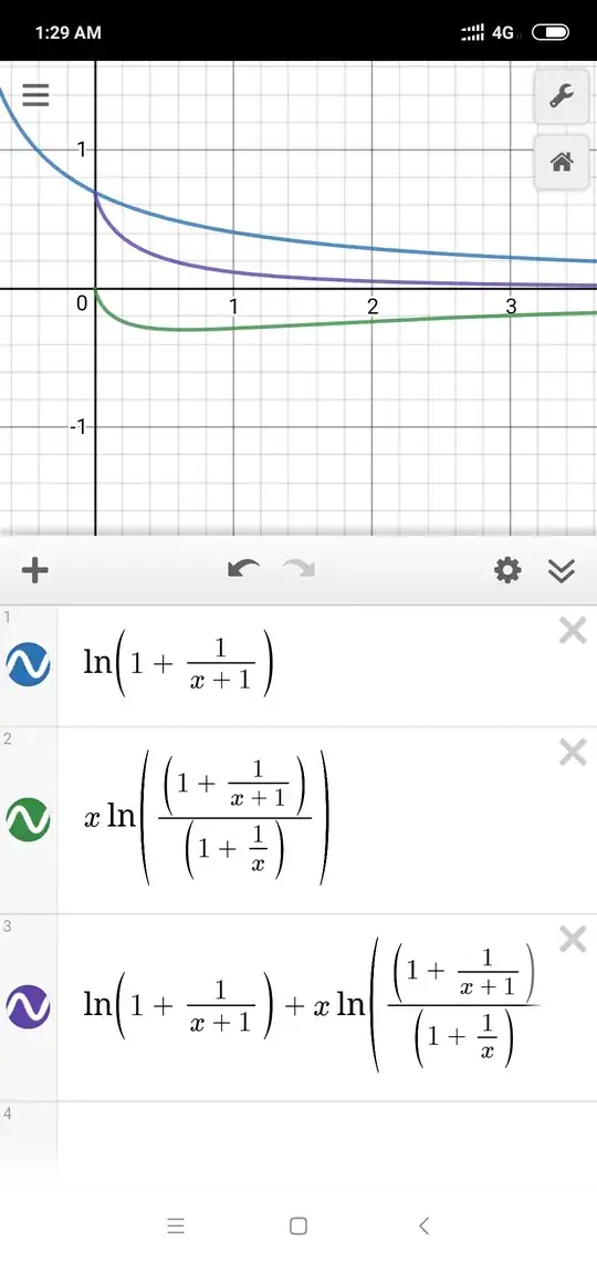

Adding graph for @Rebellos 's last equation enter image description here

  • Thanks for helping me but I have a doubt from 3rd step onwards. The 3rd term in the 3rd step shouldn't be positive and hence for the further steps also? – jayant98 Nov 05 '18 at 19:07
    @jayant98 Yes and this just made our life easier! – Rebellos Nov 05 '18 at 19:10
  • @jayant98 Did you manage to prove why the last expression holds ? – Rebellos Nov 05 '18 at 19:24
  • Nope,still trying. :| – jayant98 Nov 05 '18 at 19:26
  • @jayant98 Notice that for $n \in \mathbb N^+$, it is : $$1 + \frac{1}{n} > 1$$ and also $$1 + \frac{1}{n+1} > 1$$ Now, notice that the nominator in the logarithm is a smaller number than the denominator, since $$\frac{1}{n} > \frac{1}{n+1}$$ since $n+1 > n$ for $n \in \mathbb N^+$. Thus the expression in the logarithm is definitely bigger than $1$ and also "powered" to $n$, thus $>1$ and thus the first term is positive, since the natural logarithm is positive if the argument of it is larger than $1$. Now, the second logarithm term is also obviously positive. Thus proved ! – Rebellos Nov 05 '18 at 19:31
  • Sorry again. But, here is my thinking $$1+\frac{1}{n}>1+\frac{1}{n+1}$$ and hence $$1>\frac{1+\frac{1}{n+1}}{1+\frac{1}{n}}$$ and if it powered to n as +ve integer it will be still less than 1 and hence the 1st ln term will be negative. For example if we take n=3 it will give 3.ln(15/16) which is still negative. Sorry again. – jayant98 Nov 05 '18 at 19:48
  • Kindly look at the graph that I have uploaded. And then solve my query please. – jayant98 Nov 05 '18 at 20:03
