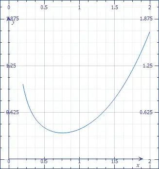

Hint:
This is not a detailed answer, but this plot says all.
  • This plot says nothing as $n$ goes to infinity. – Dr. Sonnhard Graubner Oct 30 '18 at 19:12
  • @Dr.SonnhardGraubner: the question is about the bounds. Anyway, it just takes a ruler to find the limit on the plot. –  Oct 30 '18 at 19:38
  • @YvesDaoust could you please tell me how you create that plot? I would like to play with the graph and see whether i can get any insights from that. – roman Oct 31 '18 at 13:36
  • @roman: that was made with Microsoft Mathematics, but I can't see what better insight you can get. All you need is there. –  Oct 31 '18 at 13:45
  • @YvesDaoust I'm actually trying to develop an algebraic solution for the problem. Hopefully I can notice something on the plot. – roman Oct 31 '18 at 13:46
  • @roman: there is nothing relevant to be seen "outside the plot". On the opposite. –  Oct 31 '18 at 13:59
