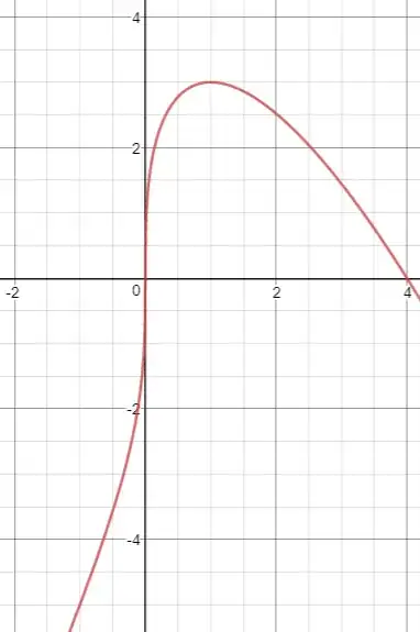

$x=1$ is not an inflection point (as you can see from the graph below).
On the other hand you missed another inflection point $x=0$! Perhaps your book mistakenly wrote $x=1$ instead of $x=0$. The reason you missed $0$ is because the function is not differentiable at $0$ (and for such points, the condition of $f''(x)=0$ for inflection points obviously fails).

There is only one stationary point. Since $f(0)=0,f(1)=3,f(4)=0$, $x=1$ cannot be an inflection point as $f$ increases then decreases.
