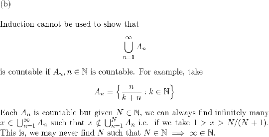

On Slader I find this solution. I have pasted it below:
I don't quiet understand the reasoning above and why should it imply (does it?) that the infinite union would not be countable.
