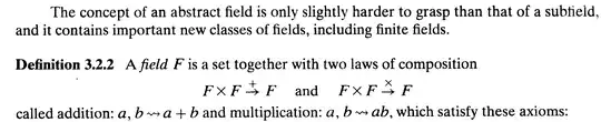

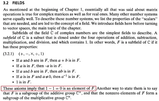

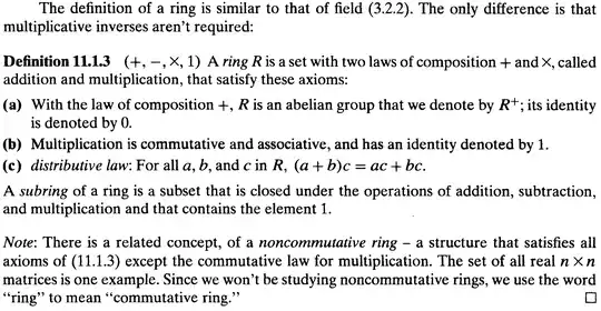

Artin has different definitions of rings particularly that his rings are commutative in both addition and multiplication. Based on his definitions, (*) I believe that $0$ is in subrings for the same reason $0$ is in subfields: (**) $$1-1=0$$
Am I mistaken?
Definition of a subring of the ring of complex numbers $\mathbb C$ (and then I guess this is extended to a subring of a ring $R$)
Definition of a ring
Earlier, subfields of the field $\mathbb C$, fields and subfields of fields were defined similarly.
Definition of a subfields of the field of complex numbers $\mathbb C$ (and then I guess this is extended to a subfield of a field $F$)

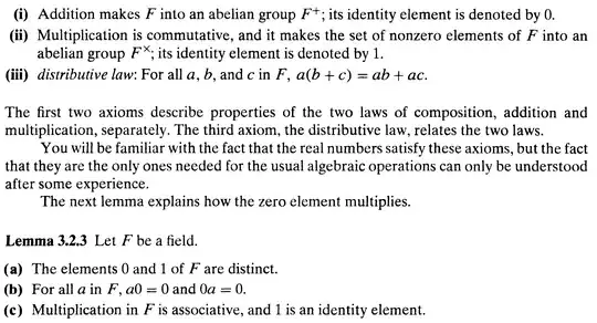

Definition of a field

    By every definition I've ever heard, a subring contains $0$ (the additive identity). You're correct in saying that it is implied by closure under subtraction and inclusion of the element $1$, but alternatively we know that subrings are rings in their own right, and every ring has an underlying additive abelian group (which requires the existence of an identity element, $0$) – Theo C. Oct 23 '18 at 02:43
  • @D.Beec Thanks! So, we could actually say to Artin that 'that subfields are fields in their own right' is an alternative proof than '$1-1=0$' to show $0$ is in every subfield? Hmmm....I mean, that $0$ is in every subfield sounds like part of the proof of showing that every subfield is a field. So, how would you show that every subfield is a field without using $1-1=0$ to show $0$ is in every subfield? – BCLC Oct 23 '18 at 02:48
    Here's an alternative way to consider it: Let $F$ be a field with the given operations of $+$ and $\times$. We call $A$ a subfield of $F$ if $A\subseteq F$ and if $A$ is a field with respect to the same operations $+$ and $\times$. Now, in 3.2.1 Artin is trying to provide a minimal set of properties that if true, show that $A$ is indeed a subfield of $F$. In this list, he doesn't explicitly state "$A$ must contain the additive identity", but that property is implied by this list. He's trying to keep the list short so if you ever have to check for a subfield, you can do it quickly – Theo C. Oct 23 '18 at 03:02
Subrings contain $0$ because they are, in particular, groups (written additively). Recall that a ring is a group written additively with a mutliplicative structure. So, not all rings have 1 but all rings have 0 since that is the identity element in the underlying group.
So, why does a subring contain 0? Because it is a ring and so, in particular, an abelian group written additively. Hence, contains an identity which in this case would be 0.

    It is slightly more subtle than that. Consider that if we don't explicitly require a subring to contain $1$, then the subring may still contain a multiplicative identity that works in that subring. For example $\mathbb Z/6\mathbb Z$ could have ${0,3}$ as a subring, with $3$ filling the role of the multiplicative identity. This situation cannot arise for additive identities because a ring is an additive group. In a group the equation $a+a=a$ characterizes the identity uniquely, and therefore the subring's $0$ must necessarily equal the $0$ of the larger ring. – hmakholm left over Monica Oct 23 '18 at 02:54
    Thanks for point that out. I should have been more specific. It seemed OP was asking about why they contained 0 conceptually not as the distinguished element so I was a little careless. – RhythmInk Oct 23 '18 at 02:56
  • Thanks RhythmInk and @Henning Makholm! Turns out I might be pretty screwed for the GRE because Artin defines rings to include $1$. – BCLC Oct 23 '18 at 03:08
    Most folks do. What you will encounter on the GRE will very likely be rings with unity. In the most general case, a ring not have a multiplicative identity, but most folks only bother considering rings with unity in their texts. I would suggest looking at Pinter's introduction to abstract algebra as well. A more basic text that'll help with intuition. Feel free to send me a message if you would like to chat more about this kind of thing. – RhythmInk Oct 23 '18 at 03:10
