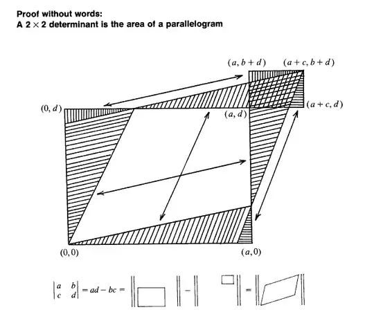

Or more informally, here is a proof by picture using inclusion exclusion of areas for a 2x2 matrix:
area between two vectors is the determinant of the matrix
Is there an analogous picture for the corresponding $n=3$ and the more general mapping to permutations $n$ arbitrary situation? I don't immediately see that adding a vector to the 2 by 2 case translates to doing three versions of 2 by 2 and adding or subtracting accordingly. How do the volumes overlap when they are sheared in three dimensions? (note that the picture proof assumes a particular ordering of magnitude of $a, d > b, c$; presumably the proof works with minor mods for other orderings and considering largest first).

  • What exactly are you trying to prove? That the $n$-dimensional hyper-parallelipiped spanned by $n$ vectors $v_1, v_2, \ldots, v_n$ can be split into $n!$ simplices, each of which is congruent to one with vertices $0, v_1, v_2, \ldots, v_n$ ? – darij grinberg Oct 22 '18 at 14:36
  • @darijgrinberg I want to prove the usual 'determinant=hypervolume' statement but each term in the sum (from one of $n!$ permutations) would correspond to some subvolume (whatever it might correspond to). They don't have to be congruent. I'd expect that they're not, but maybe you have a proof where they are. In the elementary proof by picture. the subareas are not congruent. – Mitch Oct 22 '18 at 15:32
  • Ah, I see what you mean! – darij grinberg Oct 22 '18 at 15:42
  • OK, slow attempt in progress... $n$ vectors have $n^n$ rectilinear 'boxes' ($2^2 = 4$, $3^3 = 27$ etc). How to get only $2! = 2$, $3! = 6$ 'boxes' to contribute to volume? wedge product is 0 for another coeff from same vector, so only permutations left..but how does this correspond to inclusion exclusion of those boxes? – Mitch Oct 23 '18 at 19:49
