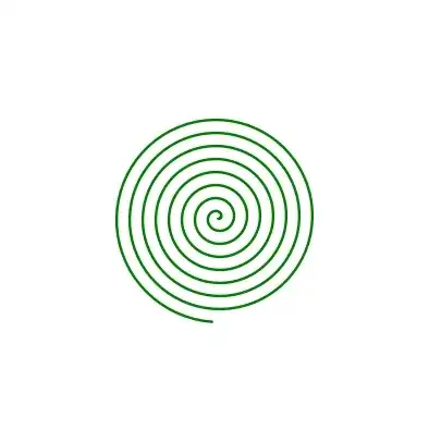

for the unit circle. Today I was thinking by myself and I wondered if there is a curve that could represent every point inside of a circle. Maybe with a spiral like this,
If you can't represent it perfectly with a curve, what would be the closest way to represent it?

    Here is a relevant reference: http://en.wikipedia.org/wiki/Space-filling_curve. The curve can't be one-to-one, but it can be done. – Jonas Meyer Mar 28 '11 at 20:34

Since topologically a disc and a square are the same, most of what you might want to know about this falls under the heading of Space-filling curves. To summarize, the answer to your main question is that the disc $D^2$ is the image of the interval $[0,1]$ under a continuous map, but not a one-to-one (non-intersecting) continuous map. So it depends on exactly what you mean by curve.
