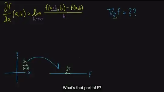

Does the idea of composing/decomposing the fraction notation of the derivative from/into differentials apply in multivariable calculus? I realize that this practice is considered non-standard and many don't like it even in single variable calculus, but we can multiply both sides of $dy/dx = f'(x)$ by $dx$ yielding $dy = f'(x)dx$, and invert the process by dividing both sides by $dx$ to return to the original equation.
In the multivariable world, differentials are more diverse. Instead of having only one dimension in which to nudge the input value of a function, we can take an indefinitely small step in an infinite number of directions, a prime candidate being ∂x, a tiny nudge in the direction of the x-axis, as shown.
Similarly, $∂y$, $∂z$, etc., represent nudges parallel to the relevant input axes. However, the formula one comes across for the differential of $f$ in multivariable calculus is interesting.
Firstly, "full differentials" ($df$, $dy$, etc.) are present, whereas one might expect to find "partial differentials" ($∂f$, $∂y$, etc.). What is the meaning of full differentials in multivariable calculus? Secondly, dividing through by one of the differentials would yield an equation whose truth isn't obvious. For example, dividing by $dy$ results in $df/dy = f_x dx/dy + f_y + f_z dz/dy$. Again, it's not clear what $df/dy$ means when $f$ has a three variable input. Does this invite thinking about the inputs as living on three non-continuous number lines rather than in a single three-dimensional space, whereas $∂f/∂y$ would indicate the latter? What about $dx/dy$ and $dz/dy$, which are input-to-input nudge ratios; are these concerning since they don't involve the output of the function at all (i.e., it might not be possible for $z$ to be a function of $x$)? Is this equation and the others like it valid, and are they useful?
