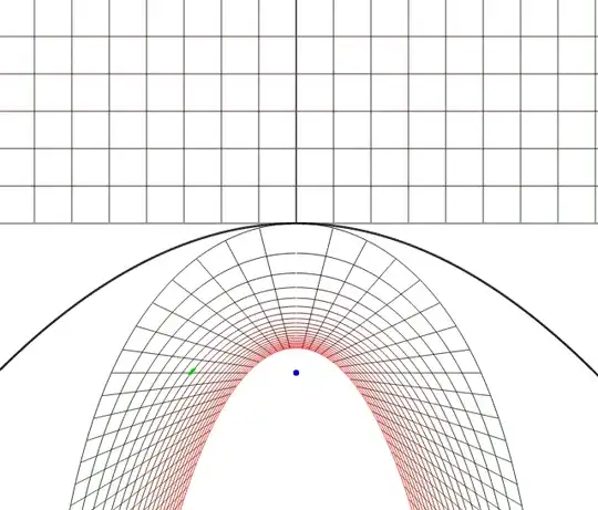

For example, the reflection of a grid takes the following apparent shape: enter image description here
I am attempting to figure out whether the bowed curves created by the horizontal lines form a particular named shape. To do so, I am trying to reparametrize the curve in terms of some $\hat{x}(t)$ and $\hat{y}(t)$, but I'm unsure of how to proceed. For example, I previously suspected that they might be confocal parabolas (though probably not) and would like to rearrange terms so as to show what they are.

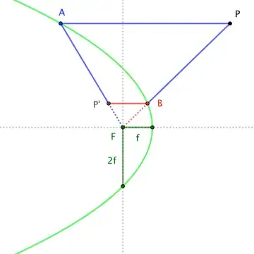

Here's a derivation based using a left-opening parabola with the focus at the origin, with $f$ the distance from vertex to focus. That is, we take the parabola to have Cartesian equation
$$4 f ( x - f ) + y^2 = 0 \tag{1}$$
In polar form: $$r = \frac{2f}{1+\cos\theta} \tag{2}$$
Now, let $P = (p,q) = r (\cos\theta,\sin\theta)$ be our reflecting point. The horizontal line through $P$ meets the parabola at $A$; line $\overleftrightarrow{PF}$ meets the parabola at $B$. Then, the horizontal line through $B$ meets the $\overleftrightarrow{AF}$ at the reflected point, $P^\prime$. The reader can verify these calculations:
$$A =\left(\frac{4f^2-q^2}{4f},q\right)=\left(\frac{4 f^2 - r^2 \sin^2\theta}{4 f}, r \sin\theta\right) \qquad B = \frac{2f}{1+\cos\theta}\left(\cos\theta,\sin\theta\right) \tag{3}$$ so that $$P^\prime = \left(\frac{4 f^2 - r^2 \sin^2\theta}{2r (1 + \cos\theta)}, \frac{2 f \sin\theta}{1 + \cos\theta}\right) = B - \frac{\left(\;r(1+ \cos\theta)-2f\;\right) \left(\;r(1-\cos\theta)+2f\;\right)}{2 r(1 + \cos\theta)}\;(1, 0) \tag{4}$$
Since points on the parabola satisfy $(2)$, we see immediately that, for such points, $P^\prime$ reduces to $B$, which coincides with $P$. $\square$
Note that the Cartesian form of $P^\prime$ is $$P^\prime = \frac{1}{2\left(p+\sqrt{p^2+q^2}\right)}\;\left(\;4 f^2 - q^2, 4fq\;\right) = -\frac{p-\sqrt{p^2+q^2}}{2q^2}\;\left(\;4 f^2 - q^2, 4fq\;\right) \tag{5}$$ This can be put into agreement with OP's formulas by appropriate coordinate transformations. (Move the origin to the vertex via $p\to p+f$; then rotate $90^\circ$ via $p \to -q$ and $q\to p$.)

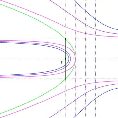

As for the reflections of lines perpendicular to the parabola's axis ... Such a line has polar equation $r = k\sec\theta$ for some $k$, so that the corresponding reflected curve comes from eliminating $\theta$ from the system $$(x,y) \;=\; \left(\;\frac{4 f^2 \cos^2\theta - k^2\sin^2\theta}{2 \cos\theta (1 + \cos\theta)}, \frac{2 f \sin\theta}{1 + \cos\theta}\;\right) \tag{6}$$ The identity $\sin^2\theta+\cos^2\theta = 1$ lets us write our system in terms of $\cos\theta$. Eliminating that (with the help of Mathematica's Resultant[] command) yields $$\left(2kx + y^2-4f^2\right)^2 = 4 k^2 \left(x^2+y^2\right) \tag{7}$$
Here are the associated curves for $k=f$, $2f$, and $3f$.
Whether such a curve has a name, I do not know. It is definitely not a parabola.
Note that each curve is doubly-asymptotic with horizontal lines through the ends of the parabola's latus rectum (since the $y$ coordinate of $(6)$ approaches $2f$ as $\theta$ approaches $\pi/2$). Also, when $y=0$, equation $(7)$ reduces to $x = f^2/k$; as $k$ grows without bound, the "vertex" of the curve approaches the origin, i.e., the parabola's focus.

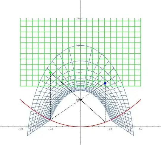

Proceeding according to your calculations [*] I got the transformation formulas a bit different with yours.
I got for the reflected point $(x_r,y_r)$ and the real point $(x,y)$
$$ x_r(x,y,f) = -\frac{2 f \left(\sqrt{(f-y)^2+x^2}+f-y\right)}{x}\\ y_r(x,y,f) = \frac{\left(\sqrt{(f-y)^2+x^2}+f-y\right) \left(f \left(\sqrt{(f-y)^2+x^2}+f+y\right)-\frac{x^2}{2}\right)}{x^2} $$
Follows a plot for $f = 0.5$. The parabola is in red. The parabola focus is a black dot, In green is the real grid and in light blue is the reflected grid. It is shown also a green point (real) and a light blue point (reflected)
I hope this helps.
