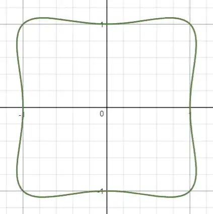

What's the area enclosed in $x^4-x^2y^2+y^4=n$?
x^4+y^4-(xy)^2=1
The image above has $n=1$.
We can convert to polar coordinates of course. $r^4[\cos^4(\theta)-\cos^2(\theta)\sin^2(\theta)+\sin^4(\theta)]=n$ Not exactly sure how that might help us.
I can approximate the area by creating some random points between $0$ and $2$ and asking how often they fall in the space enclosed by $x^4-x^2y^2+y^4=1$.
This leads me to an area of $\approx 4.3$. Can I get an exact value for this?

    @Mason the more useful branch is $y=\frac{\sqrt{2}}{2}\sqrt{x^2+\sqrt{4n-3x^4}}$, In addition to the symmetries $x\mapsto -x$ and $y\mapsto -y$, there is also the symmetries $y=-x$, $y=x$ so you just need to find the area bound by $y\ge 0$, $x=0$ and $x=y$, after subtracting off the triangle you're left with a wavy bit given by the above and this is the thing i meant you can integrate – Calvin Khor Oct 07 '18 at 22:08

You are right on the spot with the polar form. You need an area in polar coordinates, which is (quite obviously, from circle geometry):
$$A=\frac12\int_0^{2\pi} r^2\,d\phi$$
You have
$$r^4=\frac{1}{\cos^4 \phi-\cos^2\phi\sin^2\phi+\sin^4\phi}=\frac{1}{1-3\cos^2\phi\sin^2\phi}=\frac{1}{1-\frac{3}{4}\sin^2 2\phi}$$ $$r^2=\frac{1}{\sqrt{1-\frac{3}{4}\sin^2 2\phi}}$$
and finally
$$A=\frac12 \int_0^{2\pi} \frac{1}{\sqrt{1-\frac{3}{4}\sin^2 2\phi}}d\phi$$
This integral does not have a closed form in terms of algebraic and trigonometric functions, but can be put into Wolfram Alpha to calculate numerically (you get about 4.31). WA will express it with with a complete elliptic integral (one of the special functions that are not part of the "standard" set), but that's probably not that useful.
