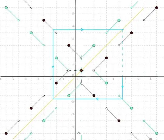

with $g=1-f$, the equation is simply $$g(g(x))=1-x.$$ Noting the importance of $(y,x)=(1/2,1/2)$ on the graph of $f$(and $g$) from the other answers, set $h(x)=g(x+1/2)-1/2$, so that $h(0)=0$. Then we see that
$$h(h(x)) = h\big(g(x+1/2)-1/2\big) = g(g(x+1/2)) -1/2 = 1-(x+1/2)-1/2 = -x,$$
So $$h(h(x)) = -x.$$
It is known that this equation has a solution on $\mathbb R$. Moreover, the solutions to both problems are in one-to-one correspondence via the above transformations. Undoing these transformations, we see that $$ g(x)=h(x-1/2)+1/2,$$ and finally $$ f(x) = 1/2 - h(x-1/2).$$ By modifying the graph from this great answer by alex.jordan, I produced a graph of a solution $f$. In $\color{green}{light\ green}$ is the graph of $g=1-f$, and you can verify that the graph is correct by following a trajectory like the $\color{lightblue}{light\ blue}$ one ($\color{lightblue}x\mapsto \color{green}g(\color{lightblue}x) \mapsto f(\color{green}g(\color{lightblue}x)) \overset{!}{=} \color{lightblue}x $.) enter image description here
