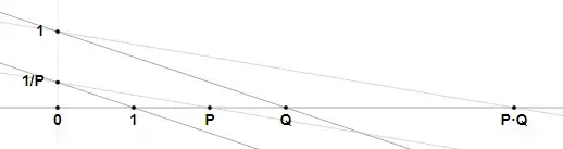

which - by the way - has a strong similarity (by the use of parallels) with the multiplication of straight lengths:

An obvious question is this: it seems the point $N$ on the circle in the first figure is meant to correspond to the point labeled $0$ in the second figures; but which point on the circle will correspond to $1$ when you make your theory of multiplication of angles?
The thing about the geometric multiplication of lengths is that the choice of unit length is generally considered arbitrary, at least in relation to classical geometry. Using the symbols $0$ and $1$ as the names of points on the line $PQ$ rather than as numbers, the construction finds a point $R$ (labeled $P\cdot Q$ in the figure) such that the lengths of the segments $01,$ $0P,$ $0Q,$ and $0R$ are in the proportion $$ \lvert 01 \rvert : \lvert 0P \rvert = \lvert 0Q \rvert : \lvert 0R \rvert.$$
This is a powerful tool. Among other things, it lets us divide any segment exactly in three equal parts. Here's how: given the points $0,$ $1,$ and $P,$ put $Q$ at an arbitrary distance to the right of $P,$ construct a point $R$ even farther to the right such that $\lvert 0R \rvert = 3\lvert 0Q \rvert,$ and relabel the point $R$ as $P\cdot Q.$ We then construct something much like the second figure using parallel lines, except that the oblique line through $P$ intersects the vertical line at a point we label $P/R$ and the second oblique line through $P/R$ intersects the line $PQ$ at a point we label $P/3.$
We know for certain there is no such powerful method for making proportional angles via a classical construction, because that method would provide a classical method for trisecting general angles and we know that no such method can exist.
