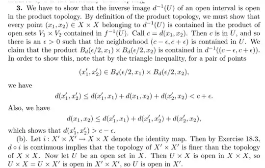

There's an alternate proof that makes use of the identity function instead of $B_d(x,r)$ from mathstuffed's Collected solutions for Munkres (Topology)
My questions:
  1. Is $d \circ i$ the $d$ in $(b)$ while $d$ is the $d$ in $(a)$? So the $d \circ i$ here is what I would call $d'$?
  2. I think both $d$ and $i$ are continuous and so $d \circ i$ continuous because both $d$ and $i$ are continuous. Is this correct?
  3. Why is $\mathcal T_{X' \times X'}$ finer than $\mathcal T_{X \times X}$? I think Exercise 18.3 would say that if $i$ is continuous then $\mathcal T_{X' \times X'}$ is finer than $\mathcal T_{X \times X}$. Is $i$ continuous? The proof sounds like $\mathcal T_{X' \times X'}$ is finer than $\mathcal T_{X \times X}$ because $d \circ i$, not $i$, is continuous. Did the proof somehow conclude $i$ is continuous because $d \circ i$ is continuous?

You're overthinking the problem. We are given a space space $X$ with a topology $\mathcal{T}_X$ which is induced by a metric $d$, meaning that the open balls $B_d(x,r)$ are a base for $\mathcal{T}_X$.
Now we have $X'$ which is another topology on the same underlying set, with topology $\mathcal{T}_{X'}$. So on the space $X' \times X'$ we have the product topology of $\mathcal{T}_{X'}$ with itself, and it is given that the metric function $d$, which is also defined on $X'\times X'$ (it's the same set after all) is in fact also continuous on $X' \times X'$ in this product topology (both with the usual topology on the image $\mathbb{R}$). The question is to show that this implies that the unknown topology $\mathcal{T}_{X'}$ is finer than $\mathcal{T}_{X}$.
Now I think that your quoted solution goes wrong: it needs to show that $i$, the identity map from $X' \times X'$ to $X \times X$ is continuous. Then the rest would go through. But the continuity of $i$ does not follow from the continuity of $d$ as far as I can see, and there is no argument given there. IMHO it tries to be too clever.
Another argument is simpler: Given that $d: X' \times X' \to \mathbb{R}$ is continuous, fix $x \in X'$. Then $d_x: X' \to \mathbb{R}$ given by $d_x(y) = d(x,y)$ is also continuous (it's just $d$ composed with an obvious map from $X'$ into $X' \times X'$) and then $B_d(x,r) = \{y : d(x,y) < r \} = (d_x)^{-1}[(-\infty,r)]$ is thus open in $X'$ too. This holds for all $x \in X'$ and all $r>0$, so the base of $\mathcal{T}_X$ (the $d$-open balls) are all open in $\mathcal{T}_{X'}$ and all open sets in $\mathcal{T}_{X}$ are unions of open balls so still open in $\mathcal{T}_{X'}$, hence $\mathcal{T}_{X} \subseteq \mathcal{T}_{X'}$.
The crux is to see the open balls, the base of the metric topology $\mathcal{T}_{X}$ as inverse images of open sets under the metric as a function.
