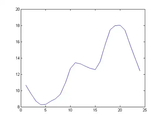

figure; plot(t,Y,'LineWidth',1.5);
grid % plot of original data Y
figure; bar(f,M); grid % plot of harmonic components as bar shape
the results of the bar figure was and now is:
t vs. Y
Now, I want to find the equation for these harmonic components which represent the data. After that I want to draw the original data Y with the data found from the fitting function and the two curves should be close to each other.

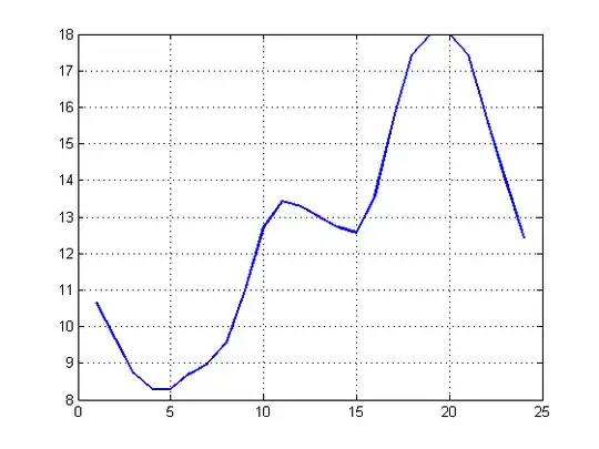

You can dispatch this problem with one line of MATLAB, f=fit(t',Y,'fourier8'), the result of which is:
f =
 General model Fourier8:
 f(x) =
           a0 + a1*cos(x*w) + b1*sin(x*w) +
           a2*cos(2*x*w) + b2*sin(2*x*w) + a3*cos(3*x*w) + b3*sin(3*x*w) +
           a4*cos(4*x*w) + b4*sin(4*x*w) + a5*cos(5*x*w) + b5*sin(5*x*w) +
           a6*cos(6*x*w) + b6*sin(6*x*w) + a7*cos(7*x*w) + b7*sin(7*x*w) +
           a8*cos(8*x*w) + b8*sin(8*x*w)
 Coefficients (with 95% confidence bounds):
   a0 =       4.889  (-4.318, 14.09)
   a1 =      -13.85  (-26.55, -1.152)
   b1 =       6.884  (-5.952, 19.72)
   a2 =      -2.135  (-2.839, -1.431)
   b2 =          13  (-2.486, 28.48)
   a3 =       6.205  (-2.355, 14.76)
   b3 =        8.53  (0.1128, 16.95)
   a4 =       6.537  (-2.725, 15.8)
   b4 =       3.137  (2.424, 3.851)
   a5 =       5.048  (0.8798, 9.216)
   b5 =      -1.603  (-6.124, 2.918)
   a6 =        1.68  (1.289, 2.071)
   b6 =      -2.345  (-5.843, 1.153)
   a7 =      -0.158  (-1.539, 1.223)
   b7 =      -1.358  (-2.395, -0.3211)
   a8 =     -0.5341  (-1.093, 0.02453)
   b8 =     -0.3162  (-0.6587, 0.02635)
   w =      0.1994  (0.19, 0.2087)
plot(t,f(t) looks like this: Eight-term Fourier series approximation
The answer to your question then is: you usually use both sine and cosine terms. The exception is if the signal is odd or even, in which case you use just sines and cosines, respectively.
