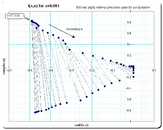

Here is a picture of the trajectory for $x_3=0.001$ and increasing n. Using to little internal precision (200 dec digits in Pari/GP) made it appear, that this converged to the 3rd complex unitroot v (where $v^3=1$) but using 800 digits precision let it converge to something near zero. I've not yet analyzed this in more detail... (Update/Correction: in the picture I've incorrectly writen $f(x,n)$ instead of $f(x,n)^2$. I'll correct the image later)
