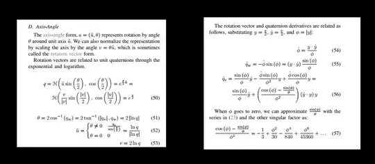

The standard mathematical equation to convert a quaternion into axis-angle form is numerically unstable when the vector part of the quaternion is small. The correct way to handle this calculation is to use the Taylor expansion of the equation when the vector part of the quaternion is small.
This numerically-stable approach is presented clearly in Neil Dantam's course notes for Georgia Tech. See equations 50-57. http://www.neil.dantam.name/note/dantam-quaternion.pdf
Excerpt from Neil Dantam's course notes, Georgia Tech.
MattKelly
  • 161
  • The answer and Taylor series is appreciated (and I encourage others to upvote), and complements the accepted answer. However, I will still keep the accepted answer since it does so in terms of relative numerical accuracy. – Damien Dec 03 '17 at 23:06
