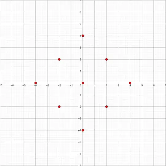

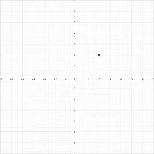

Hint:
Here is a nice way to think about what $\Bbb Z[i]/I$ looks like. You are looking at elements $\alpha, \beta \in\Bbb Z[i]$ and calling them equal if you can get from one to another by adding an element from $I$. For instance, $1+2i\equiv_I 3+4i$ since $3+4i=(2+2i)+1+2i$.
To see what $(2+2i)$, the ideal, looks like you can start by plotting the point $\alpha=2+2i$. Remember that you can add anything from $(2+2i)$ to this point $\alpha$ , including: enter image description here
  • $2+2i$
  • $(2+2i)i=-2+2i$
  • $(2+2i)+(-2+2i)=4i$
  • $(4i)i=-4$, and so on.
This should give you a new picture: enter image description here

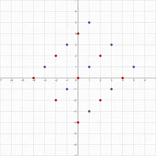

There are obviously and an infinite amount of red points, but I'm only drawing some. All these red points are infact the same element in the ring $\Bbb Z[i]/I$, so the amount of different colours needed to fill the grid is the cardinality of $\Bbb Z[i]/I$. You can continue in this way with $1+i+(2+2i)$ to get:
Another hint:
The smallest distance between two points of same colour is $\sqrt{2^2+2^2}$.
