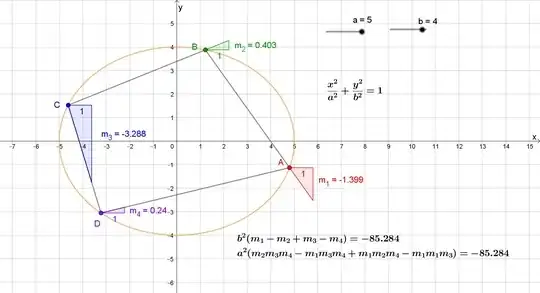

  • For an ellipse $(x,y)=(a\cos \theta,b\sin \theta)$
    $$m_1=-\frac{b}{a}\cot \frac{\alpha+\beta}{2}$$
    Transform every $m_i$ back to the auxiliary circle,
    $$\frac{a}{b}(m_1-m_2+m_3-m_4)= \frac{a^3}{b^3}(m_2 m_3 m_4-m_1 m_3 m_4+m_1 m_2 m_4-m_1 m_2 m_3)$$
    $$\frac{m_1-m_2+m_3-m_4}{m_2 m_3 m_4-m_1 m_3 m_4+m_1 m_2 m_4-m_1 m_2 m_3} =\frac{a^2}{b^2}$$

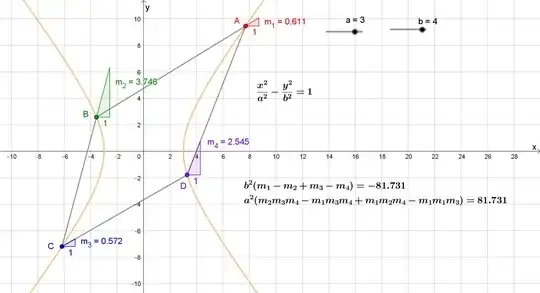

  • For a hyperbola $(x,y)=(a\cosh t,b\sinh t)=(a\cos it,-bi\sin it)$
    $$m_1=\frac{b}{a}\coth \frac{t+u}{2} =\frac{bi}{a} \cot \frac{i(t+u)}{2}$$
    $\fbox{Note that $t, u, v, w$ differ from the eccentricity angles $\alpha, \beta, \gamma, \delta$ in $(a\sec , b\tan )$.}$
    Now replace $b$ by $bi$, we have
    $$\frac{m_1-m_2+m_3-m_4}{m_2 m_3 m_4-m_1 m_3 m_4+m_1 m_2 m_4-m_1 m_2 m_3} =\frac{a^2}{(bi)^2}$$
    $$\frac{m_1-m_2+m_3-m_4}{m_2 m_3 m_4-m_1 m_3 m_4+m_1 m_2 m_4-m_1 m_2 m_3} =-\frac{a^2}{b^2}$$

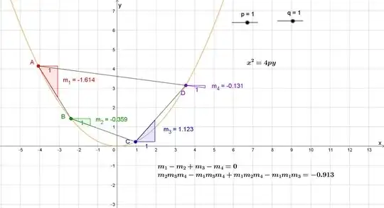

  • For a parabola of the form $x^2=4py$, take $b\to \infty$
    $$m_1-m_2+m_3-m_4=0$$

Continuing the pattern is left as an exercise to the reader. (In the case of parabolas ($\epsilon=1$), it's pretty easy!)

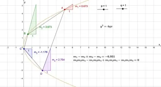

  • Yes, I think you wrote the slope wrong, because I know that for a quadrilateral on the parabola $y^2 = 4ax$ ($a \neq 0$), the relation is $\frac{1}{m_1} + \frac{1}{m_3} = \frac{1}{m_2} + \frac{1}{m_4}$. – Anon Sep 04 '18 at 16:02
    Yep. The problem with making a typo in a Mathematica script is that it propagates all the way through. :) Thanks for pointing out the embarrassing error. – Blue Sep 04 '18 at 16:15

If the conic is an ellipse with equation ${x^2\over a^2}+{y^2\over b^2}=1$, then ${A_{22}\over A_{11}} ={a^2\over b^2}$ and we get: $${m_1+m_3-m_2-m_4\over \begin{vmatrix}m_2m_4 & m_1m_3 \\m_2+m_4 & m_1+m_3\\\end{vmatrix}}={a^2\over b^2}$$
If the conic is a hyperbola with equation ${x^2\over a^2}-{y^2\over b^2}=1$, then ${A_{22}\over A_{11}} =-{a^2\over b^2}$ and we get: $${m_1+m_3-m_2-m_4\over \begin{vmatrix}m_2m_4 & m_1m_3 \\m_2+m_4 & m_1+m_3\\\end{vmatrix}}=-{a^2\over b^2}$$
But beware! The relations found above hold because xy coefficient is zero. If this coefficient is not equal to zero, we cannot state that these relations necessarily will keep valid.
