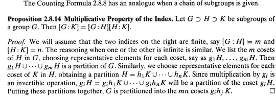

Statement of Prop 2.8.14
Let $G \supseteq H \supseteq K$ be subgroups of a group G. Then $[G:K] = [G:H][H:K]$.
Proof of Prop 2.8.14

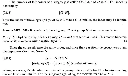

Here's the original Counting Formula (Formula 2.8.8)
Question: Could we perhaps prove Prop 2.8.14 by using Counting Formula 2.8.8? I think we could do so (Tower Law for Subgroups) if we show that $K$ is a subgroup of $H$ which I guess hasn't been proven yet, if it's even true.
