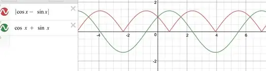

Notice that $\cos t - \sin t$ can be written in the form of $c \sin (t + \alpha)$ where $c =\sqrt{1^2+(-1)^2}=\sqrt{2}$ by using R-formula. The magnitude is not a constant as shown from a graph. For the first graph, it takes value from $0$ to $\sqrt{2}$.
Similarly for $\sin t + \cos t$, it is not a constant.
