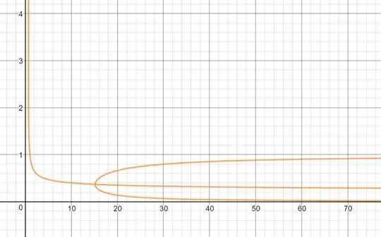

Assuming the sequence is convergent, its limit as $i\to+\infty$ is $L=\lim_{i\to+\infty}x_{i+2}=\lim_{i\to+\infty}x_{i}$ *. Hence, $L=n^{-(n^{-L})}$, which allows us to plot $L$ vs. $n$, as in the figure below (desmos). This allows us to see the fork around $n=e^e\approx15.15$ between the upper ($L\approx1$) and lower ($L\approx0$) subsequences.
I've also noticed that for the oscillating sequences ($n>e^e$), if the starting value is $x>\frac{W(\ln n)}{\ln n}$ the sequence (for odd $i$) seems to converge to the upper value $(L\approx1)$, while for $x<\frac{W(\ln n)}{\ln n}$, the sequence (for odd $i$) seems to converge to the lower value $(L\approx0)$.
* It is more useful to compare $x_{i+2}$ and $x_i$ than $x_{i+1}$, as it lets us show the oscillatory activity for $n>15$.

  • Regarding the effect of the starting values - we can plot $f_6$ (red) and $f_7$ (blue) as a function of $n$ and then vary the initial value $x_0$ (desmos). This shows that when $x_0$ is small, $f_6$ (and likewise for other even $i$) form the lower part of the oscillating sequences, while for odd $i$, the $f_i$ form the upper part. But conversely, when $x_0$ is large, this is reversed. – Jam Sep 01 '18 at 14:23
