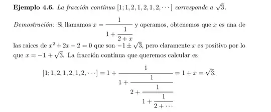

How can I solve the continued fraction of $\sqrt{3}$?
I know that a continued fraction is [1;1,2,1,2,1,2,....] -> this is the continued fraction of $\sqrt{3}$, but how can I solve? What are the steps?
I don't understand this proof.
Thank you so much.
