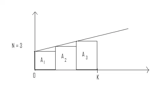

Let's say I split the area into say $3$ strips however I recount the first strip $a_1$ times, the $2$'nd strip $a_2$ times and the third strip $a_3$ times.
N is 3

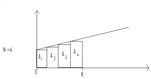

Similarly we ask about $N= 4$ and recount the first strip $a_1$ times, the $2$'nd strip $a_2$ times, the third strip $a_3$ times and the fourth strip $a_4$ times:
N is 4

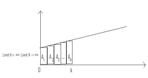

Now while this all is doable (but hardwork ?) is there any way to make it work for the case $N \to \infty$ after which I take the limit $k \to \infty$
Notice in the above pictures the area beneath the curve (in the Riemann integration sense where $a_r=1$ for all $r$) is obviously infinite. Let's add the conditions that the curve $f(x)$ is a smooth continuous function whose integral $\int_0^\infty f(x) d x $ is absolutely convergent.
