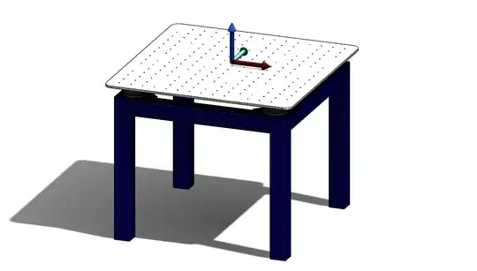

In my work, I am using a vibration table to test the resonant properties and survivability of a structure under different shaking regimes. The table is driven by an eccentrically weighted rotary motor which excites vibrations in the Y and Z axes (green and blue respectively in the image below).
vibration table with axes: x-red, y-green, z-blue

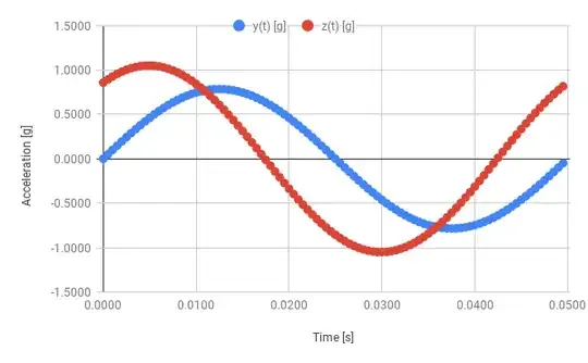

Using 3-axis accelerometers on the table and at various points on the structure, I can record the excitation and response vibrations in each axis (example plot at 20Hz below).
example plot with Y and Z vibrations

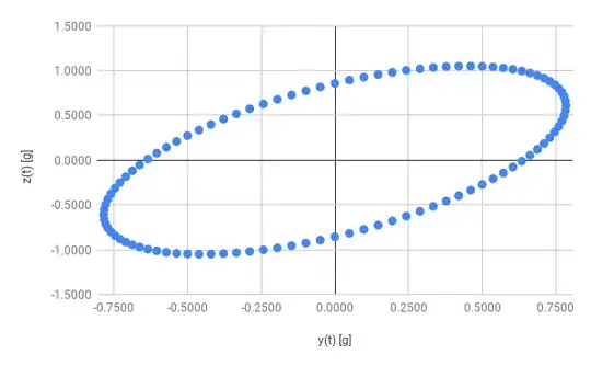

However, two sinusoids of differing amplitudes and phases define an elliptical polarization (the same data as above is plotted parametrically below).
parametric plot of the Y and Z vibrations

Based on the process discussed in this article, I’ve attempted to simply set the two forms equal to one another and solve for $A$, $B$, and $\theta$ as functions of $Y$, $Z$, and $\phi$. However, that process has yielded inconsistent results, and none of them seem to agree with the ellipse as I’ve plotted it.
I also have a gut feeling that the major and minor radii correspond to the eigenvalues/eigenvectors of some transformation matrix, but I have no idea how to go about constructing said matrix.
Numerically, the sinusoids I've plotted above have parameters $ Y = 0.7847g $, $ Z = 1.0498g $, and $ \phi = 0.9537 $. The major and minor radii are approximately $R = 1.1805g$ and $r = 0.5696g$ respectively, and the rotation angle is approximately $\theta = 1.0330$.

  • Are you sure of your value for $\phi$? From your graph one would rather guess $\phi$ to be near $-\pi/2$. – Intelligenti pauca Aug 19 '18 at 17:44
  • @Aretino, you were right. My plots and numbers had an error that I've now corrected. – uniquely average Aug 20 '18 at 23:22
