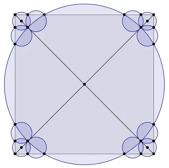

If different circle sizes are allowed, we may reach an efficiency $>76.3\%$ with just five disks:
With $13$ disks the maximum efficiency is already $>80.4\%$. It is enough to replace each "corner disk" above with three disks with approximately half the radius:

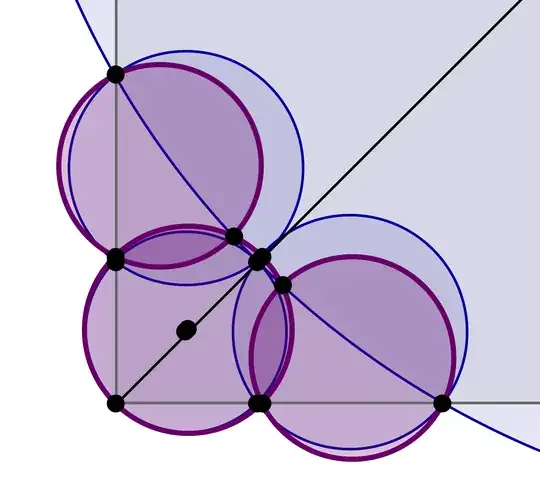

If we adjust the configuration in each corner (allowing the most external disks to overlap with the larger disk) the maximum efficiency with $13$ disk is $\geq 82.5\%$:

    Very nice. It looks to me like $12/5\pi$. – John Bentin Aug 14 '18 at 13:56
    @JohnBentin Yes, I was about to comment the same thing. The distance between the square's vertex and the nearest intersections of the circles is $1/6$. – Jaap Scherphuis Aug 14 '18 at 13:59

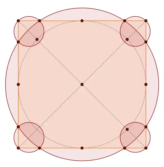

  • Even 3 circles are enough to get efficiency $>2/\pi$: let the big circle pass through two lower vertices of the square and leave two small uncovered "triangles" at the upper vertices; cover those "triangles" with two small circles. But I didn't calculate the maximal efficiency one can obtain this way. – Litho Aug 14 '18 at 14:42
  • @Litho I was just doing that too. I added it to my answer, and got an efficiency of $0.693881$. – Jaap Scherphuis Aug 14 '18 at 14:48
  • Making the corner disks larger and the adjacent disks smaller will allow you to increase the efficiency slightly. – Jared Goguen Aug 14 '18 at 20:19

  • @Alexis: how so? The blue circles are shrinking (becoming the purple ones), so the overlapped area decreases and the efficiency increases. – Jack D'Aurizio Aug 14 '18 at 21:16
  • Oh! I thought you had blue and purple circles. That makes more sense. Thanks for clarifying. – Alexis Olson Aug 14 '18 at 21:46
    What's the inscribed dotted circle in the first diagram? Is it used in a construction of the most efficient covering with that count and symmetry? – aschepler Aug 15 '18 at 01:45
  • A bit off topic, but what did you do the illustrations in? They're beautiful. – GregRos Aug 15 '18 at 09:43
  • @GregRos: the software I used is just the sponsored www.geogebra.org, it is very useful and practical, I agree. At aschepler: the dotted circle is just the inscribed circle in the original square, I used it for the construction but it is not really relevant there. – Jack D'Aurizio Aug 15 '18 at 16:15

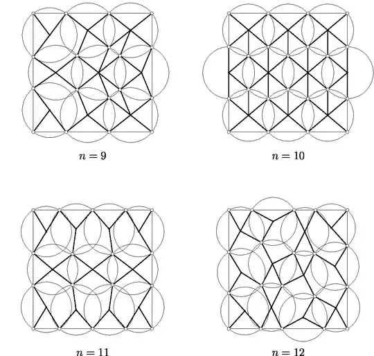

With a bit of Googling I found this paper: Covering a Square with up to 30 Equal Circles, by Kari J. Nurmela and Patric R. J. Östergård.
They used a computer search to find coverings of a square by $n$ equal circles, where the radius of those circles is as small as possible. They give a table of radius values, which I reproduce below. I've added columns with the total area of the circles and the efficiency.

As you can see, they become efficient from $n=9$ onwards. Here's a picture from that paper of the first efficient arrangements $n=9 ... 12$.
Of course it may still be possible that with fewer than 9 discs of different sizes you can make an efficient covering.

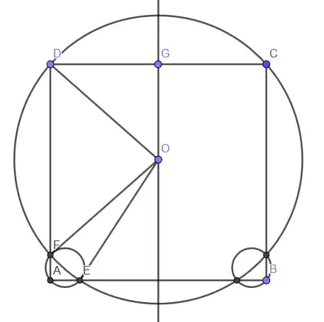

EDIT:
Inspired by Jack D'Aurizio's solution I found that you can even make an efficient 3-disc covering.
Calculating the optimal solution exactly is horrendous. Just by tweaking the numbers, the best efficiency I found with this configuration is approximately $0.693881$.
I chose the large radius to be $0.6572$, and from that it follows that $|OG|=0.426511$, $|AE|=0.179029$, $|AF|=0.146978$, and the small radius is $|EF|/2 = 0.115816$.

    I get the optimal value for $|AE|$ as the real root of the cubic $6x^3-9x^2+7x-1=0$, with $|AF|=x-x^2$. – John Bentin Aug 14 '18 at 17:52
