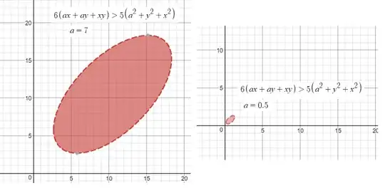

Look at the minimum value $x=6$. We have with the parameter $a$ that the couples $(b,c)=(x,y)$ that satisfy $$6(ax+ay+xy)\gt 5(a^2+x^2+y^2)$$ are all inside an ellipse. Making $a\ge b\ge c$ these ellipses they grow with $a$ but this $a$ can tend to zero and the corresponding ellipse tends to be a point. enter image description here Here I do not see clearly the formation of a possible triangle. I leave the question here.
