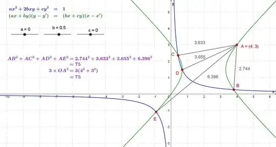

Also, is the sum $OP^2 + OQ^2 + OR^2 + OS^2$ constant for any rectangular hyperbola, or is it something special about $xy = c^2$?
It is worth noting that a geometrical solution would probably also help us understand whether or not the result is general - addressing the second query.

See also another answer here and also the case for ellipse here.
