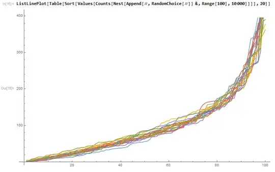

I'm also interested in playing this game with a larger amount of distinct colors to start with. I tried doing just that in Mathematica with a bag starting with 100 colors and applying the procedure 10,000 times. I'd then take the counts of each color, sort them, and plot a graph of the counts from least abundant color to most abundant color. I did it with this line of code:
ListLinePlot[
 Table[Sort[
   Values[Counts[
     Nest[Append[#, RandomChoice[#]] &, Range[100], 10000]]]], 50],
 PlotRange -> All]
And the graph looks like this And the graph looks like this
I'd like to learn more about this problem, but I don't have enough experience outside of Calculus to know where to really begin.
