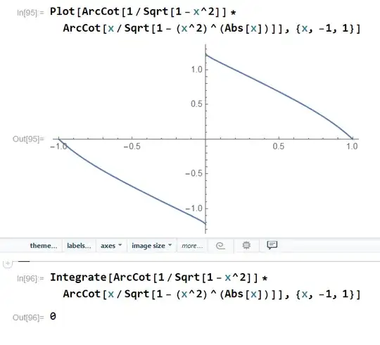

Your integrand is an odd funtion, so:
$$\int_{-\text{n}}^\text{n}\text{y}\left(x\right)\space\text{d}x=0\tag1$$
Using Mathematica I got:

  • so its the answer $0$ wrong? And how do we know when to use which identity of $\cot^{-1}x$? Op didnt state which one to use originally. – Zacky Jul 31 '18 at 18:41
  • The answer $0$ corresponds to $\cot^{-1}(-x)=-\cot^{-1}(x)$ and the answer here corresponds to $\cot^{-1}(-x)=\pi-\cot^{-1}(x)$. So depending on how we define $\cot^{-1}(-x)$, $0$ could be right. – robjohn Jul 31 '18 at 18:54
