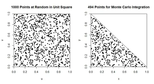

Example: In the following simulation in R statistical software, $m = 1000$ points are generated in the unit square, of which about 500 within the triangle $T$ are used. For $(X,Y)$ distributed according to this bivariate normal distribution, $P[(X,Y)\in T]$ is approximated as 0.06776, whereas one can show by a geometric argument that this particular probability is exactly 0.06773.
set.seed(818); m = 10^3
u = runif(m); v = runif(m); keep = (u + v < 1)
x = u[keep]; y = v[keep]
.5*mean(dnorm(x)*dnorm(y))
[1] 0.06776174
