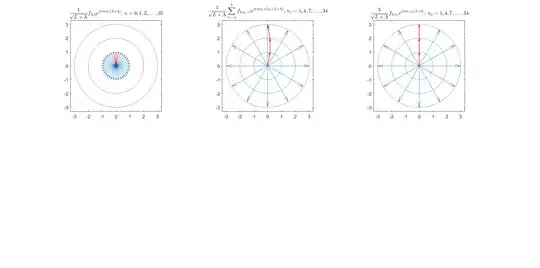

"The terms in the sum can be lumped together" means that it can be possible to sum every $\Delta n_j$ consecutive terms (the resulting sum can be called lumped term) and then consider the series of such lumped terms as equivalent to the original series. In building such a lumped term some approximation can be made of the kind here illustrated. Fourier Transform
In the first diagram I plotted as an example the sequence $$\frac{1}{\sqrt{L+\Lambda}}f_{\Lambda, n}e^{2i\pi nx/(L+\Lambda)}$$ on $36$ points only, at $x=1$, with the hypotheses that $L+\Lambda=1$ and $f_{\Lambda, n}\equiv 1$.
Supposing to lump together terms every $\Delta n_j = 3$, the corresponding piece of sequence that results is displayed in the second diagram. You see that for instance the three consecutive red terms (all with unit modulus) sum up to a term whose modulus is a bit less than $3$.
This lumped term can be substituted for by an approximated lumped term given by $\Delta n_j$ times one of the consecutive terms to be lumped as if all such consecutive terms had the same phase. In the third diagram, such an approximation is displayed, where the approximated lumped term is taken as three times the central term of the consecutive terms to be lumped.
Note that such an approximation can be affected heavely by $f_{\Lambda, n}$ that I've been considering constant in the diagrams. If it takes values too different the lumped terms could no longer be approximated by one of the original terms multiplied by the number of consecutive terms, because such terms would have very different moduli and phases. But this is not a problem because whatever is the level of approximation you want there will always be a real value such that, whatever is $\Lambda$ greater than this value, that level of approximation is attained (as you can see by $(29.3)$).

  • Certainly you do make a point but based on what I think is it not that because as $n$ changes by one unit $k_n$ changes only slightly and this in turn makes each term to vary only slightly with each other therefore this will transition to the concept of limits where if $\Delta n$ is infinitesimal then $k_n$ would be even smaller hence the function can be continuous if we change the sum to an integral wherein we change $\Delta n$ to $dn$. Correct me if I'm wrong. – mathemania Aug 06 '18 at 05:19
  • The bigger the $\Lambda$, the less consecutive terms vary w.r.t. each other (where by term is meant $f_{\Lambda, n}e^{2i\pi nx/(L+\Lambda)}$ in $(29.2)$ and "consecutive terms" means terms with $n$'s on a small integer interval). This is because the two factors of these terms have separately this same behaviour. In particular $e^{2i\pi nx/(L+\Lambda)}$ acts that way, as I have shown with the diagrams, while $f_{\Lambda, n}$ acts that way because of $(29.3)$. This behaviour justifies the use of approximated lumped terms and what follows from their use. – trying Aug 06 '18 at 07:51
  • Yes, so that means what I'm thinking is correct. – mathemania Aug 06 '18 at 13:10

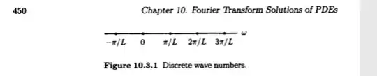

I have a slightly different book that defines this differently. The motivation for the Fourier Transform can be seen from the following. This is from Richard Haberman - Applied Partial Differential Equations with Fourier Series and Boundary Problems
In solving boundary value problems on a finite interval $-L < x < L$ with periodic boundary conditions we can use the complex form of the Fourier Series
$$ \frac{f(x+)+f(x-)}{2}= \sum_{n=-\infty}^{\infty} c_{n}e^{\frac{-in \pi x}{L}}$$
Where $f(x)$ represents a linear combination of all the sinusoids that are periodic with period $2L$ then we have the Fourier coefficients as
$$c_{n} = \frac{1}{2L}\int_{-L}^{L} f(x)e^{\frac{-in \pi x}{L}}dx $$
now then we have $ -L < x < L $ as our region of integration. So we extend it to $ - \infty < x< \infty $
$$ \frac{f(x+)+f(x-)}{2}= \sum_{n=-\infty}^{\infty} \left[ \frac{1}{2L}\int_{-L}^{L} f(\bar{x})e^{\frac{-in \pi \bar{x}}{L}}d\bar{x} \right]e^{\frac{-in \pi x}{L}}$$
For periodic functions $ -L < x < L $ the number of waves $ \omega $ in a distance of $ 2 \pi $ are then
$$ \omega = \frac{n \pi}{L} = 2\pi \frac{n}{2L}$$
giving us the distance between waves $$ \Delta \omega = \frac{(n+1) \pi}{L} - \frac{n \pi}{L} = \frac{\pi}{L}$$
$$ \frac{f(x+)+f(x-)}{2}= \sum_{n=-\infty}^{\infty} \left[ \frac{\Delta \omega}{2\pi}\int_{-L}^{L} f(\bar{x})e^{i \omega \bar{x}}d\bar{x} \right]e^{-i \omega x}$$
Then the fourier transform here is as $ L \to \infty $. The values $ \omega $ are the square roots of the eigenvalues so they get closer and closer $ \Delta \omega \to 0$
$$ \frac{f(x+)+f(x-)}{2}= \frac{1}{2 \pi}\int_{-\infty}^{\infty} \left[ \int_{-\infty}^{\infty} f(\bar{x})e^{i \omega \bar{x}} \right]e^{-i \omega x} d\omega$$
Then the fourier transform is
$$F(\omega) = \frac{1}{2 \pi} \int_{-\infty}^{\infty} f(\bar{x}) e^{i \omega \bar{x}} d \bar{x} $$
The notation is that our interval $ - L < x < L$ has extended to infinity as you see. This is commonly what happens when you have some Riemann sum and take the discrete intervals and you let them go infinitly small.
