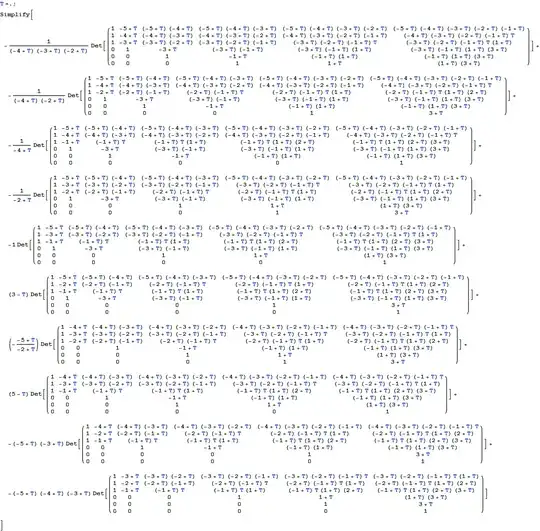

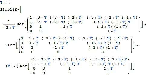

Update 2: By simplifying the relationship in Update 1 we end up with a following different relationship: \begin{eqnarray} &&\sum\limits_{2 \le q_0 < \cdots < q_{d/2-1} \le d} (-1)^{d^2/2} \prod\limits_{j=-d+1}^{-2} \left[ \frac{(T+j)^{\sum\limits_{\xi=0}^{d/2-1} 1_{-2 \xi-1 \le j \le q_\xi-d-2} \cdot 1_{q_\xi\ge d-2 \xi}}} {(T+j)^{\sum\limits_{\xi=0}^{d/2-1} 1_{q_\xi-d-1 \le j \le -2\xi-2} \cdot 1_{q_\xi\le d-2 \xi}}} \right] \cdot \left| \begin{array}{r} \left(\prod\limits_{j=q_\xi}^{q_\xi+\eta-2}(T-d-1+1 \cdot j)\right)_{\eta=1}^d\\ \left(\prod\limits_{j=q_\xi}^{\eta-1} (T-d-1+2 \cdot j)1_{q_\xi \le \eta}\right)_{\eta=1}^d \end{array} \right|_{\xi=0}^{d/2-1} =\\ &&2^{\frac{d^2}{4}-1} \cdot \prod\limits_{\xi=0}^{d/2-1} (\frac{1}{2})^{(\xi)} \xi! \end{eqnarray}
For example if we take $d=4$ the left hand side reads:
which is independent of $T$ and reads $-4$.
Likewise for $d=6$ the left hand side reads:
which again is independent of $T$ and reads $192$.
Now, again how do we prove that relationship rigorously?
