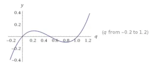

Here I plot the differences $f(i) - f(i-1)$: $$ f(3) - f(2) = -3q^2 + 2q3 + q $$ enter image description here

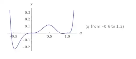

$$ f(4) - f(3) = - 4q^3 - 3q^4 + 12q^5 - 6q^6 - (- 3q^2 + 2q^3) $$ enter image description here

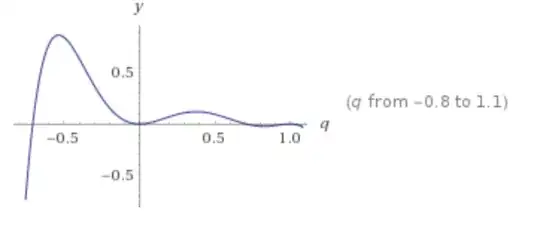

$$ f(5) - f(4) = - 5q^4 - 10q^6 + 20q^7 + 30q^8 - 60q^9 + 24q^{10} - (- 4q^3 - 3q^4 + 12q^5 - 6q^6) $$ enter image description here
Visuallly all the difference functions are positive for $q < 0.5 (i.e. $p > 0.5$)$ (i.e. conjecture is supported).
