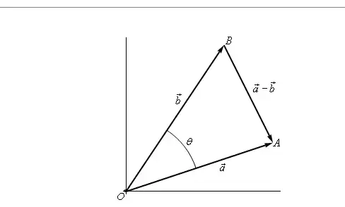

The intuition is gathered from the following, given by the Law of Cosines
$$\| a -b\|^{2} = \| a\|^{2} + \| b\|^{2} - 2\| a\|^{2} \| b\|^{2}\cos(\theta) $$enter image description here
$$ \| a-b\|^{2} = (a-b)^{2}\cdot(a-b)^{2} $$ $$ \| a-b\|^{2} = a\cdot a - a\cdot b - b\cdot a + b \cdot b $$
useful to note that $a \cdot a = \| a\| $
$$ \| a-b\|^{2} = \|a \| - a\cdot b - b\cdot a + \| b\|$$
further more we have $ a \cdot b = b\cdot a $ $$ \| a-b\|^{2} = \|a \| - 2 a\cdot b + \| b\|$$
so we have
$$ \| a\|^{2} - 2 a \cdot b + \| b\|^{2} = \|a\|^{2} + \|b\|^{2} - 2\|a\| \|b\| \cos(\theta) - 2 a \cdot b = -2 \|a \| \|b\| \cos(\theta) $$
yielding finally $$a \cdot b = \| a \| \| b\| \cos(\theta) $$
Now suppose that
$$ \|a\| = \|b\| =1 $$ $$ a \cdot b = 1 \cdot 1 \cos(\theta) = \cos(\theta)$$ ok when is this negative. We have a unit circle here for vectors
$$ a \cdot b = \cos( \theta) < 0 \implies \frac{n\pi}{2} < \theta < \frac{3n\pi}{2} $$
that is we are in one part of the circle. However, it goes on forever.
