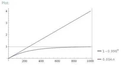

On the other hand, if you have a very low probability of success, then probability of at least one success is approximately proportional to number of trials.
The graph below maybe illustrates this better than my words, but since probability of success is very low (for instance, 0.4%) then probability of two or more successes is A LOT lower (0.0016%, 0.000064%, etc., so basically negligible) so if several experiments are repeated total success rates will closely match the number of times, on average that 'one' success occurs.
Probability for at least one success with probability of 0.004, for 1 to 1000 tries (straight approximation, actual curve):
