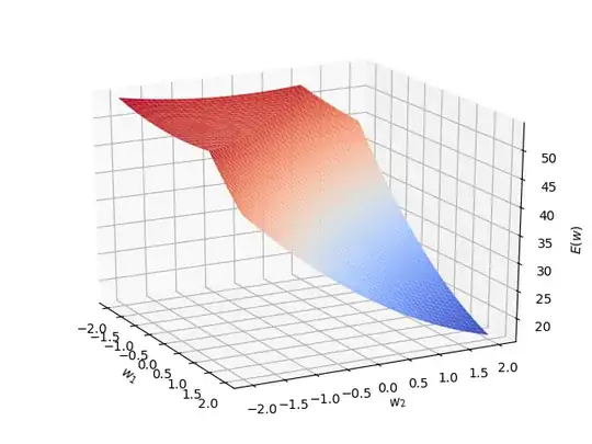

Here's at least a partial answer to what you're asking, I think.
You want to know whether or not the function $E$ is convex in $w$ if we take the activation function $f$ to be $\operatorname{ReLU}$.
The answer is no: consider a very simple network with two inputs (and a bias $b=1$) and one output. Suppose we have just one input pattern (i.e. $|D|=1$), which is the vector $x=(1,\ 1)$. Suppose the desired (target) output is $t=10$. The network is parameterized by the weight vector $w=(w_1,\ w_2)\in\mathbb{R}^2$. If we take $\lambda=1$, the error function is given by
\begin{align*} E(w)&=\frac{1}{2}\big(t-\max\{w^\text{T}x+b,0\}\big)^2+\frac{1}{2}\lambda\|w\|^2\\ &=\frac{1}{2}\big(10-\max\{w_1+w_2+1,0\}\big)^2+\frac{1}{2}(w_1^2+w_2^2). \end{align*}
However, we can plainly see that this function is not convex:
Non-convex error surface for simple neural network

  • This is a bit counter intuitive to me since ReLU is convex. Is there a way to check if a function is convex without plotting or checking if the Hessian is positive definite? – Karl Alexius Aug 01 '18 at 14:53
  • maybe by knowing the basic convex functions and knowing the operations that preserve convexity? – Karl Alexius Aug 01 '18 at 14:53
  • @ThanksBye that's a good idea. There are many such results. For example, the composition of two convex functions is not, in general, convex. But there are other useful results. This question is one place to start. – David M. Aug 01 '18 at 15:03
