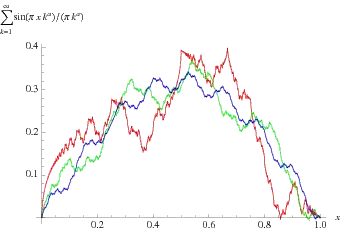

I am aware of a few example of continuous, nowhere differentiable functions. The most famous is perhaps the Weierstrass functions
$$W(t)=\sum_k^{\infty} a^k\cos\left(b^k t\right)$$
but there are other examples, like the van der Waerden functions, or the Faber functions. Most of these "look like" some variation of:
Weierstrass Function from Wolfram.
(Weierstrass functions from Wolfram)
Specifically, they are clearly not invertible. Since these functions are generally self-similar at many scales, this non-invertability would seem to hold essentially everywhere.
I'm wondering if it's possible to construct such a function which is invertible. Intuitively, maybe this would be "jittery" in the same way as the Weierstrass function, but if it had a slope which always increased, it would be invertible. Or perhaps there is at least an example in which the function is invertible over some segment of the range.

    Looking at the graph, why can't you just use W(x)+cx, with c>>1 they should become invertible? – Aganju Jul 17 '18 at 00:57
    @Aganju: my intuition for that is "how big should c be?" It essentially behaves like a fractal, with small scale variations. How can you be sure that $c$ will be large enough over a well-controlled range? But indeed, that's why I asked the question is I had something of a similar thought in mind. – levitopher Jul 17 '18 at 01:03
  • 16
    @Aganju basically, you would need to choose $c=\infty$, because the function drops down arbitrary steeply locally. – leftaroundabout Jul 17 '18 at 05:27
