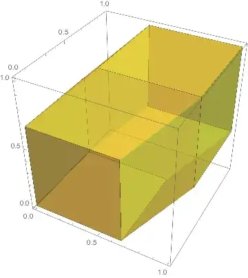

Here's the volume in $x$, $y$, $z$ space:
Max[x,y,z]-Min[x,y,z] < 2/3
Integrate the region's volume to find that the probability is $20/27$.
