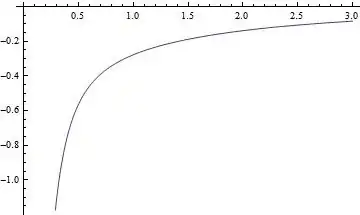

Let $u:=a^2, v:=b^2, w:=c^2$, we have $u+v+w=3$.
Consider the function $$f(x)=\ln (1+x^{\frac{1}{2}}+x^{\frac{3}{2}}),\ 0<x\leq 3$$ it's easy to compute that $f''(x)<0$.
by Jensen's inequality, we have $$\sum\ln (1+u^{\frac{1}{2}}+u^{\frac{3}{2}})\leq3f(\dfrac{\sum u}{3})=3\ln 3$$ that is $$\prod(a^3+a+1) \leq 27$$ When the max occurs, we have $u=v=w\Rightarrow a=b=c$
Q.E.D.
By the way, I draw a graph of $f''(x)$ on $(0,3]$ by mathematica to show it more directly...
Shane
